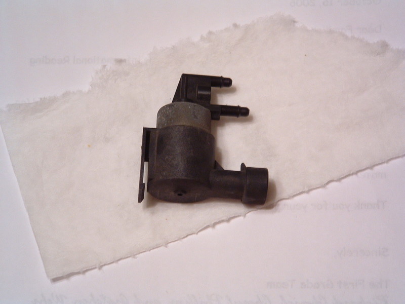

2) The vacuum switch (located on the firewall http://www.kylestubbins.com/files/bl...uum_switch.jpg) or vacuum diaphram (located under the battery) could be malfunctioning. The job of these components is to pull on a cable which engages the front, right 4WD hub. I don't think this is likely to be your problem as you should probably hear the encoder motor running (changing the drive mode from 2Hi to 4Hi/4Lo) but there is a sensor on the hub to tell the TCCM when it is engaged, so it could be problem.
