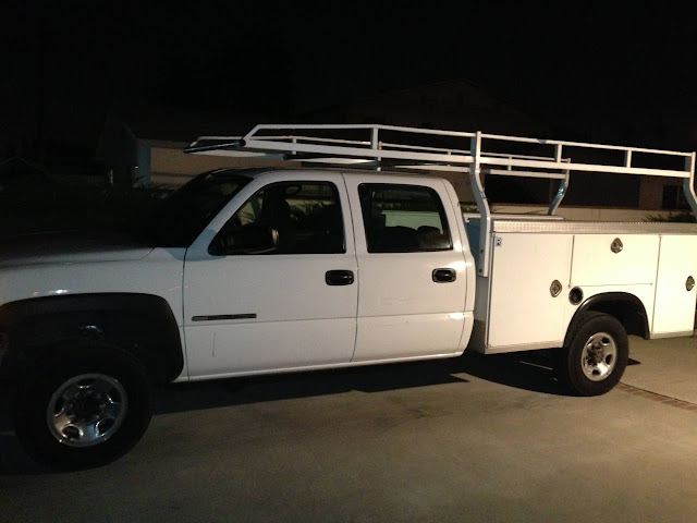

New member here. Trying to take care of my dad's Sierra 2500HD Utility Truck for his construction job.
Anyone have recommendation on a good independent shop to get the truck serviced in Pasadena / Los Angeles area. Went to the dealership for an alignment and was told that the front suspension is pretty much shot....needs upper and lower control arm ball joints, idler arm, pitman arm, steering gear box, etc. etc. Close to $3500 in repairs and didn't seem right and wanted a second opinion because the truck drives fine, does not feel rough or issues with steering.
