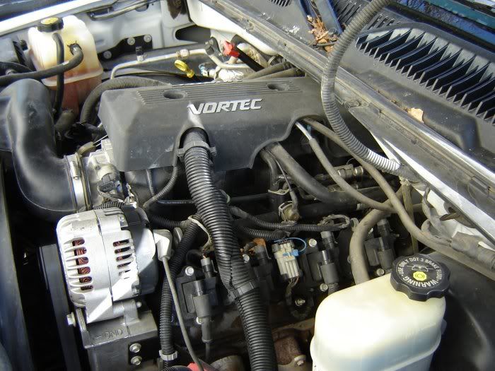

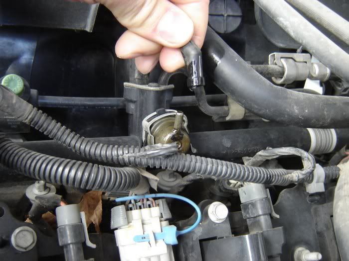

Fuel pressure regulator leaking fuel to vacuum lines are common in the 5.3 vortec which is what's causing rough running when started up or hard starts.
Here are some pictures of the regulator and location, as well as pictures of the fuel present on the vacuum side which should not be there at all.

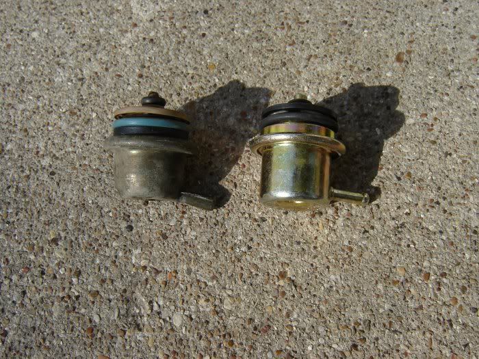

Here are pics of the regulator and replacement. The new replaceent was a little different and likely an
improved design. Notice the collar which is plastic on the old one is built into the unit and metal on the
new one.
