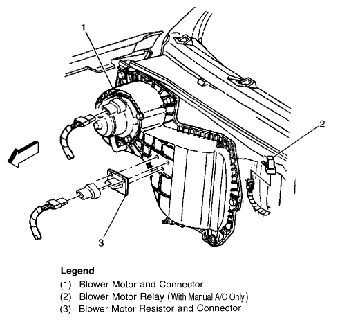

Hi I am wondering where the blower motor relay is on a 1997 gmc jimmy. Thanks I’m advance
If it is like the Blazer it is:
It is located at the left rear of the engine compartment, on the blower box:
graphic
