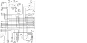

My fuel pump recently went bad and i replaced it. If i jump the pump ( lol ) it will start pumping, but for some reason there is no power going to 1 of the relays and im not sure what could cause it...alternator?
99 Sonoma SLS 4.3LYou'll prolly need a wiring schematic to look at in helping find problem. what year/motor? also check your reg.fuses.
so have you tried just 12v to pump and ran? if so, pump and ground circuit ok (I was thinking maybe a bad ground). Have you checked for 12v on gray wire at pump...making sure your test equip. has a good ground?heres a schematic from a 01 which should be the same...if you're sure of no power/good grounds(at left frame rail opposite pump/tank and the one at the end of rail for taillights) then trace back. could be a rotted wire at a splice in loom.My fuel pump recently went bad and i replaced it. If i jump the pump ( lol ) it will start pumping, but for some reason there is no power going to 1 of the relays and im not sure what could cause it...alternator?
